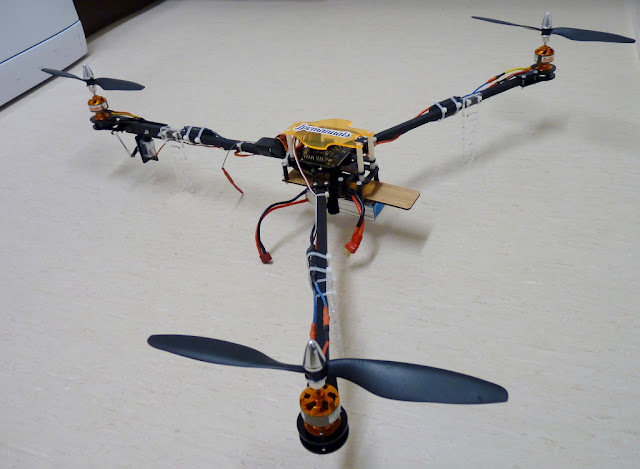

It's finished (for LOS anyway)!!
Did some fiddling for a few hours calibrating ESCs and configuring the GUI, but I managed to complete the build tonight and even got a cheeky maiden in the dark, lit only by a security floodlight lol :)
had a few teething issues as usual, the tri just wanted to yaw really bad, but ignoring the multiwii manual that says to have all 3 props spinning the same way solved it. I now have the front two countering each other.
the flight after that was perfect, autolevel works brilliant straight outta the box so to speak (default settings) and tomorrow in daylight (and larger space) I'll be testing the altitude hold too.
here she is, flight ready and just begging for a GoPro w/vtx up front. I'm very pleased
